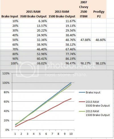

They say a picture is worth a thousand words. The issue with the 2015 ITBM is it does not scale the brake input with the brake output, keeps the output linear but on the low side, as the brake input increases, the scaling factor decreases. Calibration? Maybe an error converting to engineering units, I don't know.
Your trailer stopping experience will be based on the amount of power the trailer brakes need. If they need more than 7 volts, you are out of luck.
I didn't fully characterize the Chevy or the P2 since they both use voltage, getting late and didn't feel like doing all the math. Doesn't matter, as you can see, they both fall in line with the brake input request and the output of the RAM 1500.

I've been watching this thread because my ITBM will be installed in my 2015 Ram 1500 next week. This last graph looks positive for the 1500's. Thank you for sharing and correct me if I'm wrong.
I need to make clear on the chart the RAM 1500 is a model year 2013, and the 3500 is a model year 15. It looks as if Chrysler changed the ITBM to a new part for MY15, the same ITBM is used in all RAMs.
