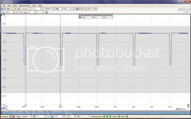

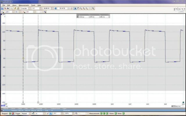

I posted scope shots of the trailer brake line (in the cummins forum thread), one with a working ITBM and my 2015 tow vehicle, the scope shots clearly show my 2015 is only outputting 63% power to the trailer brakes.
Brake slider all the way pushed (100%), 100% output from ITBM 12.6 amps measured on the trailer brake wire.
Brake slider all the way pushed (100%), 63% output from ITBM 6.1 amps measured on the trailer brake wire.
