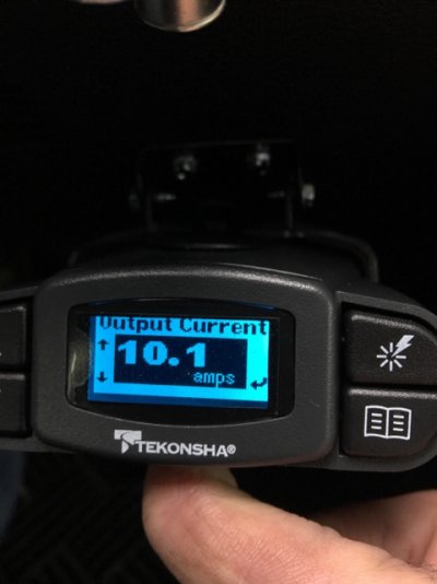

P3 and cable came today. Will install and test pull this weekend.
Grantopus
Jan 16, 2017
6
6.7
Trailer stops now with the prodigy installed!! Current went from 6A to 10A+ much better.

Were you able to lock up brakes on the trailer?
No I couldn't lock them up. Even when cranked up to 14 gain. But they do work 10x better than with the OEM controller.
