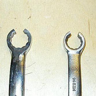

Do NOT use regular wrenches to remove & replace the hoses
Chances are that you will round off the fittings
Use a Line wrench
Use a Line wrench
I know this video is about Ford brake lines, but they have several good tips about wrenches & cleaning & rust removal products to use before you break the line loose
The mistake I would have made.
