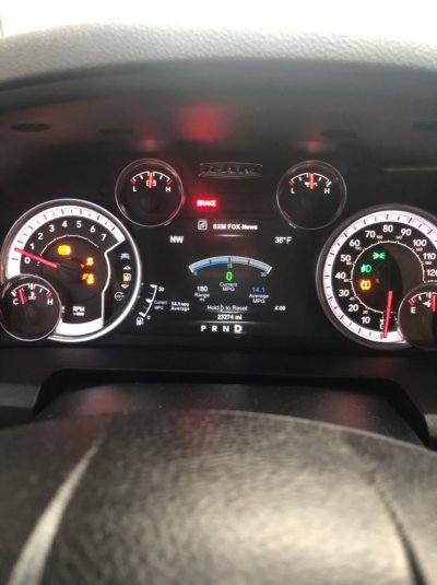

Is this normal for traction control to be disabled via i2 tuner ??

Custom tune for headers and then went in to “quick adjust “ after tune was installed and deleted traction control via tuner .
I do know that the 2014 are different 2015 pcm cracking wise. Maybe that has something to do with the difference

That’s quite the hassle . I don’t think I have a problem . It just had it happen immediately when I disabled tc via tuner. With custom tune alone the brake light and abs light weren’t on . I’m guessing the tune writer just disabled traction control not the whole system.

Now I understand why those lit up. You turned off traction control with the programmer. Normally that's not recommended. You can disable it for drag racing but for everyday I wouldn't recommend it. Your ABS system is now no longer working as well as the electronic stability control and, of course, traction control.
If you enable it, the lights will go away and all your safety systems will be operating as designed..
