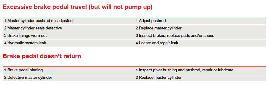

A lot of this issue seems to be related to the master cylinder now that I've been reading my Haynes manual a bit more thoroughly. I doubt it's air and believe that the master cylinder has gone bad, as there is no leaks to be seen.
