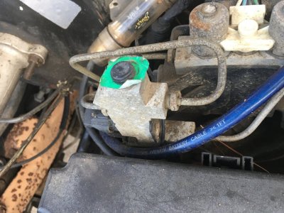

Ok, so there is no fluid coming into or out of the ABS module, then went to what I guess is the proportioning valve (with the green thing on it) and there is fluid going in, but not out of it. I guess it is bad and i need a new one? See pics of my rig and the brake stuffIMG_7049.JPG IMG_7046.JPG

I believe that is the proportioning valve. I would try to find one at a junk yard.
Just to confirm you have fluid coming into that? But not coming out to the lines? try disconnecting the line that is not receiving fluid and pumping the crap out of the breaks, you are trying to essentially dislodge the rust / sludge build up.

I can confirm that there is fluid in the lines going into the proportioning valve, but no fluid coming out of the proportioning valve. Pick-n-pull is having a 1/2 off sale this weekend, so i will likely just get another one from there.

Well, I replaced the proportioning valve, and that fixed the problem. Rear brakes working great.
