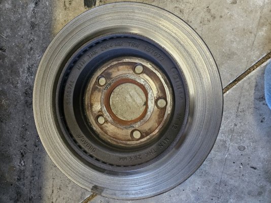

Sorry for the delay, life happened.....lol. Replaced brake pads, and the noise was still there.
Pulled calipers and rotors. E-brakes look surprisingly good, no loose pads.
I can hear slight noise when I rotate the rear axles, video link here:
I am thinking my only option is to do new bearings, seals, and diff oil.
Thoughts?

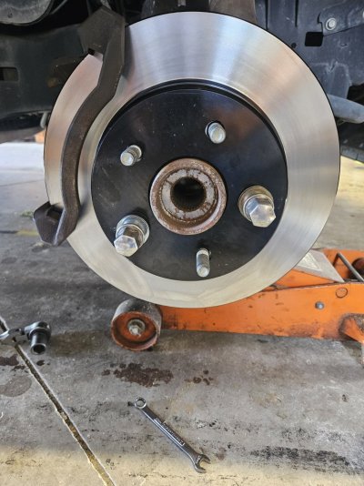

Update: I'm the idiot here.
Changed my rear pads, had a stuck rear axle bearing, installed 2 OE bearings and new seals.
Rear noise improved, hearing noise from front now, got ready to replace front pads, and discovered I totally missed that I have backing plate to rotor contact on my passenger side inside pad.
Waiting on 2 rotors from RockAuto, then hopefully all will be right in the world.
I feel so stupid having missed it. Looks like the friction pad went bye-bye. Lesson learned.
However, I feel much better having replaced the rear axle bearings, especially after finding the one that was stuck.

The rear backing plate? Or the front dust shield? If it's the front dust shield touching....you should check your bearing/hub assembly. The shield could be bent, but it could also be a worn front bearings and it's slightly cockeyed ...allowing the rotor to touch. Just a thought.
EdGs
EdGs
Nov 29, 2020
5,481
11,627
FL
The backing plate for the pad. Passenger side front, inside pad.
Dust shields are fine. I don't know yet if the whole friction pad is gone or if it wore unevenly.

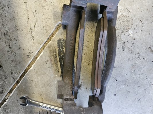

Here is the last issue:
Passenger side pads, inside is gone. It must've been stuck. I will have to watch the wear on this, incase there is still a problem on this side.
All better for now.....
Were the slide pins bone dry?
I'll bet that the rotor was a hoot to remove, not. :cool:
The pins still had grease on them, I cleaned and regreased them. The guide grooves were clean also, no buildup of crud, etc.
The rotor came right off.
I am fortunate to not live in the rust belt, I cannot imagine having to deal with that.
That's odd, it looks like the calliper wasn't floating freely enough if the inboard pad was finished with that much more material remaining on the outboard pad.
Up here, it would be best if you regreased the pins often because they dry out, at least on the older vehicles.
Better set a reminder to review that often when the new pads get close to the end. :cool:

Yeah, I thought it was odd for that one pad to be that much worse than the other. I will definately have to pay closer attention to it.
For having 80k miles on them, all the pads were in great shape except that one.
They're all changed now, so we will see.

Did you change calipers to Ed,as a sticking caliper piston can cause that oddball pad wear
EdGs
EdGs
Nov 29, 2020
5,481
11,627
FL
No, I did not.
I will be changing brake fluid in a few k miles, on the short side of 194k now.
I will see if there's a temperature difference on that wheel soon, just to see what's going on.
