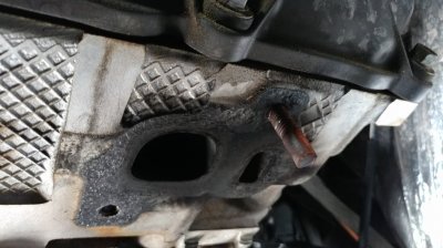

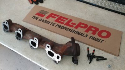

I just did the entire passenger-side on the wifes Dodge.. Cost me $30 including the tool to put the plastic revits in on the fender. Took me less than an hour.
It's not that hard, I replaced all the bolts and gasket as well.
I guess it depends how deep your bolts snap . Yours does look fairly easy if they snapped that high up. Mine are deeper and need to be extracted
You machine the manifold flat again? Or was it not warped?
