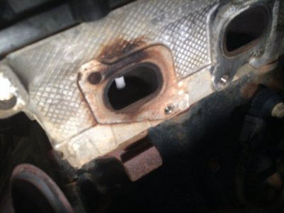

So my truck failed a va inspection for an exhaust leak. They said a bold had broken. When i looked the back stud on the pass side was gone.
After i pulled the manifold it was broke clean off at the head

Had to drill it and use an easy out

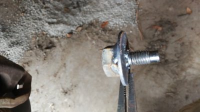

Thumbs up I had 2 broken i got 1 via easy out second one had to be welded as to not mess up the head I couldn't get a stright drill on it. Not a fun job but you can now knock it off your bucket list.

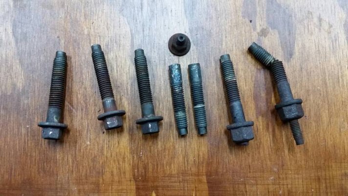

Good news, got all 8 out. Back two had just the head broke so the stud was sticking out. Front top was broke right at the engine. Drilled tiny and worked up to the ez up. Out it came. I heated all of them before wrenching. New ones going back in.

Why put stock bolts and manifolds back in? They suck and warp and break constantly. After all that work I would upgrade... headers and stage 8 bolts or ARP manifold bolts.
