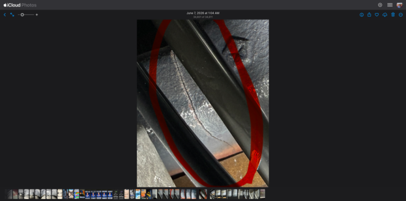

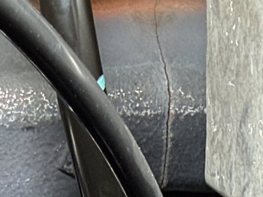

I finally got the left heat shield off. Looks like a cracked manifold is the culprit. Appreciate all your assistance. Going to go with BD Manifolds and the Remflex 6022 gaskets.
