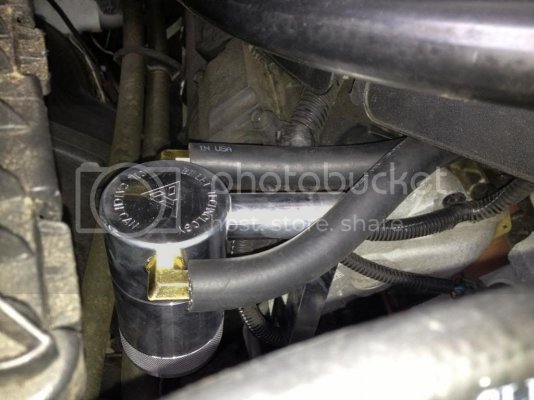

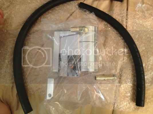

Got a BT Catch Can from my lady for our 5 year anniversary. Ordered from Moe's, thanks Matt for the heads out. For the record Matt your not in trouble from my lady lololol. Going to attempt to install it today, i'll post a couple pics of it installed here.

Yeah she is. Question: is their an angle my catch can should be? Cause I see some that are leveled flat and some that are tilted.

it should be sitting level not tilted.

What are some of the symptoms of any hoses disconnecting from the BT or the ends? Lets say I'm driving and the hose disconnects from the connector at the back of the manifold. How will I know that it's disconnected?

I dont think it will throw a code or anything like that. You will just have oil leaking out....and the hoses fit really tight so you shouldnt have a problem.

There isn't much pressure going through those hoses, so they shouldn't come disconnected on you if installed properly. If you are worried about it, you can always throw a hose clamp on the ends as well, but that is overkill IMO.

I had my hose come off while I was adjusting the tilt and motor was running, motor almost stalled from to much air going in but didn't throw any codes.

Thanks a lot peeps for the info and comments. I had to install it in the rain, I couldn't wait any longer lol. Next is the Y pipe.

I appreciate the fact that in his second picture he is wielding it like excalibur. lol I'm gonna be that happy when I get home to install my catch as well.

Was actually holding it like a beer mug for cheers but excalibur would do also lol
