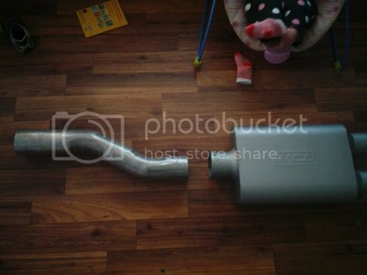

so heres the start got the pipe bent before the kids woke up gonna get it moked up and weld the hangers on then powder coat the pipe and muffler
heres a pic of what I go so far I may do a right up in diy if theres enough interest
and if any one is curious my total cost is 102.50 Canadian
you do need a pipe bender (or a friend with a shop like me that don't care what you do there ) and a welder to do this
don't nock the muffler till you hear a sound clip this are basically exactly the same as a flowmaster delta 40 (very mean sounding muffler)

its all done now tail pipes arent perfect ones 1/8 inch lower then other il get a sound clip soon it sounds mean as hell
