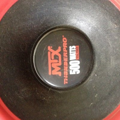

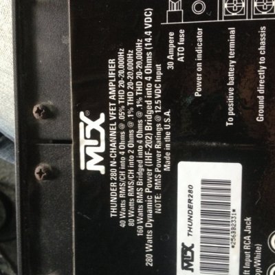

This thing is close to 20 years old. It just says "Thunderpro 500 watts total power" on it. My amp is an MTX Thunder 280. Looking at the specs, it sorta looks under-powered, but I remember it sounding good when it was working. I'm not sure if I should go ahead and break the seal on the sub in the box and see if there's more info on the magnet.
I'm sorta wondering if I should just ditch both of these and get some moderate upgrades since my birthday is coming up next month.

Good god man lol i thought i was an old school fan talking about stuff from about 10 years ago. You are running gear from when i was in elementary school. Very cool stuff however i would recommend buying some new stuff. I actually had to look up your sub and it looks like it may even be older than the Blue Thunder series. A couple things: Your amp was never designed to run a sub like this. Secondly, your sub certainly has some years on her. One of the most concerning things to me would be the foam surround on it. 20 years is really pushing it. I would not be surprised if the foam itself started to degrade and even the adhesive securing it to the woofer cone and basket. I would recommend some new equipment. A lot has changed over the years and you wouldn't need to spend a whole lot on something that will run with that setup of yours. Food for thought.
You may be able to get some decent money for this equipment on ebay from the right buyer also. This stuff is old enough to be back when MTX was american built. Some people are enthusiasts for the old school stuff.

Oh god, I'm old. lol. Yeah, this was my set up just out of high school. Alright, thanks for the advice. I think I'll start planning for a new set up rather than mess around with something that may need to be replaced shortly anyways. I'll decide on a new sub or two and then start designing the fiberglass box around that.
