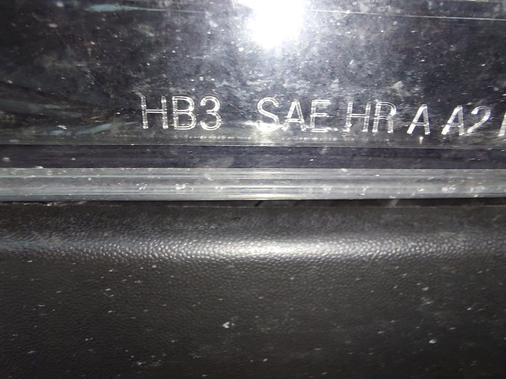

The Projector housings on my '21 Warlock have the bulb type embossed on the front.
HB3 is a 9005.

My projector housing says the same as yours, HB3 and the manufacture date is 10/15. The funny thing is that the 9005 bulb does NOT fit in the housing.

That's odd.
The spec and the housings indicate 9005.
Is there any possibility the bulb you tried wasn't a 9005?
Or you had a moment with the assembly? :cool:
Are you not the original owner and the socket may have been modified?

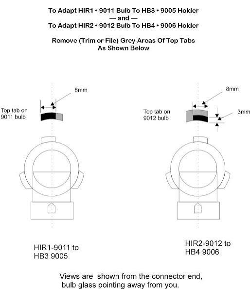

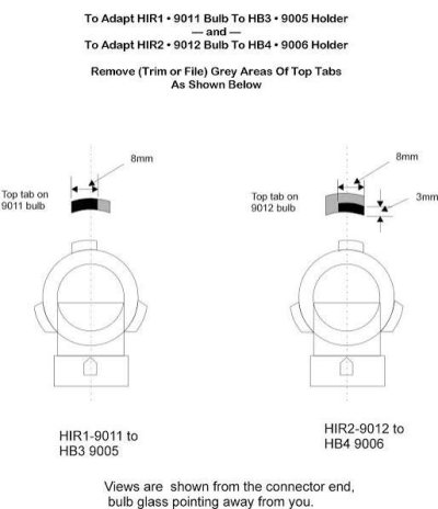

I have a H11 bulb that I will try and if that does not fit, I will purchase a set of 9012.
H11 is the size for the reflector Low beams, the factory projectors are either 9012 or 9005 for the Lows depending on the year..
9012 and 9005 can be interchangeable with slight modification
