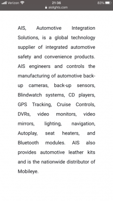

Sounds like they sell a lot of Chinese/knock-off electronics based on such a wide variety of products they sell. I’ll stick with brands I know.
Let’s see some output pics.

Also, there’s no list on the site for vendors or links, just an email request form.
That’s a giant NOPE from me.

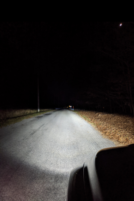

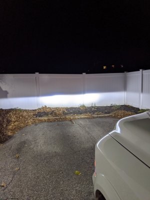

Got them installed today, once i get some more drive time ill give a full review.
As for just installing them i like them, they dont really seem brighter then my 45w hid's but a better color. They have a different cut off, not as sharp maybe but a whiter color.
They seem to project wider to me, distance was pretty much the same.
There is that dark spot just in front, doesnt seem to be an issue plus i have morimoto 2stroke fogs.
I clocked them 3/9 with the longer part on the bottom.
They fit great with stock covers, i used some green slime grease (rc car shock seal lube) so the bulb clocked easily with out ruining the silicone gasket.
These are way brighter then my 35w ddm 5500k bulbs.
Couple hid vs led pics....
45w hid
Lumibright led
45w hid
Lumibright led
Lumibright cutoff
