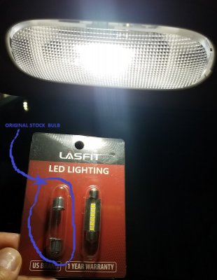

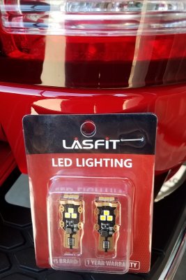

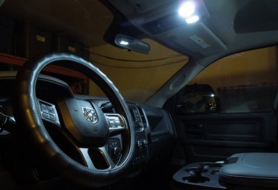

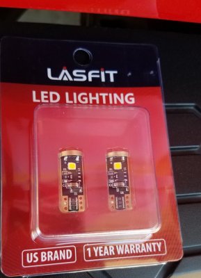

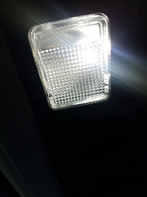

Hi Guys,
After reading a bunch of stuff on the Forum and the WWW, I just decided to buy some LASFIT Canbus Error Free LED bulbs for the interior map lights, the rear dome light, the reverse lights, the cargo roof lights, and the third brake lights. I bought them from Amazon and they seem to all have a one year warranty. I think I spent $75 all in and have an extra 3rd Brake Red LED bulb as well as a Rear Dome Light LED Bulb for the future if needed.
I installed the interior bulbs (they are almost to bright in the front), the reverse (big improvement), and the license plate bulbs today.
20180830_175145.jpg Dome Light LASFIT Canbus LED 42mm Bulb.jpg License Plate & Map LASFIT Canbus LED Bulb (package front T15).jpg Map Lights LED (pic2).JPG Rear Dome Light (pic2).JPG
I will install the roof cargo LED bulbs and the LED 3rd brake light bulb (as well as do the leaking 3rd brake light seal upgrade mod).
So far so good with not chimes or messages in info center in cluster.
I hope this was a bit informative and helps anyone wondering but i did watch and lookup any and all forum posts and YouTube videos to learn a little as well
I will have to get the brake/turn signal LED bulbs at a later date as well as work on the front end exterior LED bulbs
REAR DOME LED LIGHT BULB (Canbus Error Free):
LASFIT 42mm LED Festoon 211-2 212-2 569 578 Bulb Canbus Error Free 400LM 6000K Extremely Bright Use for Raer Dome Light, Xenon White (Pack of 2)

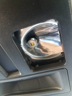

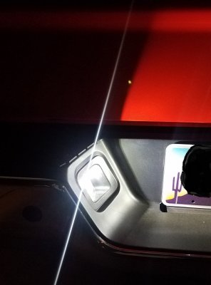

Here is a few more pics of the LED Bulbs I did on the back end outside of my 2018 Dodge Ram 2500 4x4 Hemi 6.4L (License Plate and Cargo lights)License Plate & Map LASFIT Canbus LED Bulb (package front T15).jpg License Plate LASFIT Canbus LED Bulb T15.jpg DSCN4043_LI (2).jpg LASFIT 921 Canbus White & Red LED Bulbs For 3rd Brake Light & Cargo Lights (Package FrontsS).jpg LASFIT 921 Canbus White LED Bulbs (Cargo Lights).jpg

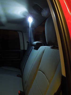

I decided the LASFIT 42mm LED Festoon 211-2 212-2 569 578 Bulb Canbus Error Free 400LM 6000K Extremely Bright Use for Rear Dome Light and the LASFIT 194 168 T10 192 2825 W5W LED Bulb Canbus Error Free, Non-Polarity 400LM 6000K Extremely Bright for Dome Map Courtesy Bulbs were way to bright for real world use. They almost hurt your eyes at night with a total of 600 lumens of output at night at 6000k color. they did perfectly match the outside bulbs color and intensity though...
I just installed 5000k Color V-LED 80 Lumen white bulbs in the map lights and they are perfect and still pretty white in color and not yellow. Amazon.com: VLEDS 2pcs 80lm 5000K White 194 T10 2825 360° Long Life 1 LED Bulb: Automotive
I also installed a V-Led 5000k Color 230 Lumen (although says 170 Lumens as measured) bulb in the rear cab light and they are much nicer in intensity and color and match the front ones perfectly. They don't scare you awake or hurt your eyes at night. Amazon.com: VLEDS 1pc 230lm 42mm 5000K White 211 212 560 578 6411 360° Long Life 24 LED Festoon Bulb: Automotive
I was hoping to get the V-LED 4 row LED High Output bulb but it is not on Amazon and I think it would be a bit brighter but not necessary. WHITE HIGH OUTPUT 48 LED 360° 42MM 211
Neither of these bulbs say they are canbus but I have no messages or indicators they are incorrect or out in my info center in the dash and it has been days...

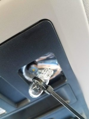

Oh, Somewhere in a video or this forum I learned this handy trick to remove those bulbs. I can't take any credit for this handy piece of knowledge though...
20181107_134213.jpg 20181107_134221.jpg 20181107_134243.jpg 20181107_134347.jpg
