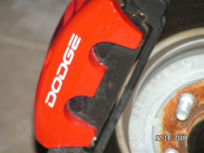

I saw these on eBay for 6.99. I was wondering if anyone has tried them out?

I thought someone on here had them a while ago and said they were junk I can't find the thread though.

I must have missed the thread. I wouldn't think these things would very last long unless they were on a show vehicle.

I saw a post somewhere that said Hemibabe had some on her truck, but the post was a year old. Maybe..?
Anyway, why not use the stickers as masking?
Clean the calipers, prime, put down a white base coat (or whatever color you want the letters to be) then put the sticker on and finish with the color you want the calipers.
Remove stickers... and watch the magic happen.

I've seen people use them before. Paint the caliper the color you want, apply decal, and last step most forget is to clear it. Helps keep the decal in tack and keeps it on the caliper.
