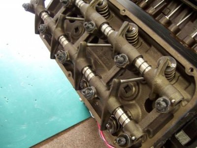

If you're looking at long tubes, check out Pacesetter 72C2211. They have a coated Y pipe to match it. Apparently you haven't been under your valve covers lol. No adjustment on rocker shaft Mopars lol. Stab and seat the pushrods in the lifters, set the rocker shaft with arms in place, start tightening in sequence. Ensure pushrods are in place. Torque to spec. Anyone with the ability to custom tune (CMR or HPtuners) can write out your rear O2's (and EGR should you decide to remove it). Probably want a higher stall converter with that cam, though the 4.56's will help. Higher rpm cam ina heavy ass quad cab can work but needs the supporting mods.

Youre right. Never been under the covers. Wasnt sure if they shared a shaft or what. Thats easy enough.

Yep, dual rocker shafts, just like its two predecessors:
