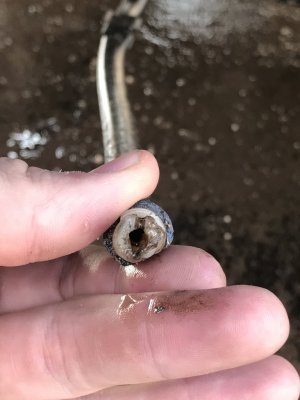

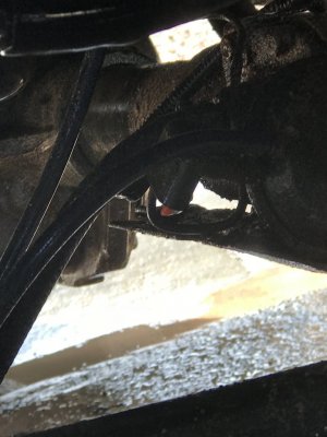

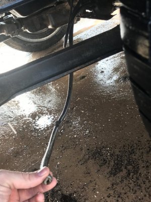

Came out this morning to this hose hanging down. Says fuel 5/16th on it. Located behind front passenger tire. Did some playing off road yesterday so wondering if it got caught on something?

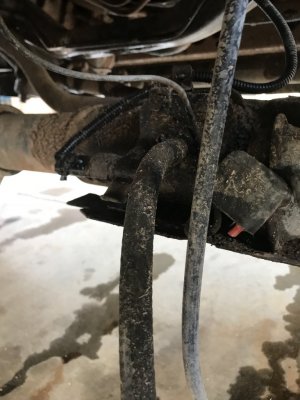

Looks like the breather tube for the front axle. Pin it back up somewhere high and above ground clearance, leave some slack for suspension travel.

Yup, googling some images and that’s it. I was stressing for a moment. Just put 3K worth of work into the truck (it’s my toy) and was like “come on”. Thank you sir!

No problem. Had that happen on my '99 Ram while storm chasing a few years back. I ended up putting a longer hose on it, putting the end cap back in and zip tied it up near the hood hinge.
