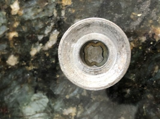

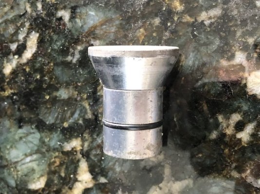

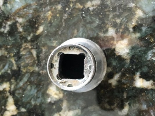

Thanks for the ideas. Tried getting something over security gizmo, could not get anything to work. Pipe wrench idea worked, slow but sure, and a tight fit for arm. A small piece of the plastic guide cone was broke from my first attempt, and I was able to use a chisel and hammer to remove the gizmo. Now it will work just like a truck without the theft device. Thanks again for the ideas.
