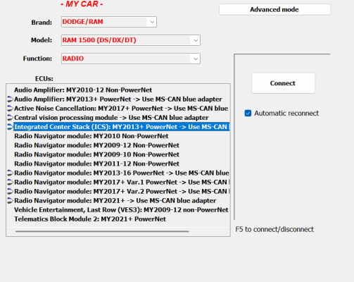

The Radio security code isn't the same thing as the RF hub pin.
The RF hub pin is for programming key fobs. Connecting to the Radio Frequency Hub is pretty irrelevant. You should be connecting to the Radio.
To get your radio code, you'll probably need your radio's serial number and to use a service like this one, or similar:
Although, if you connect to the Radio with AlfaOBD, there is this option. I've always wondered if it would bypass the security code by imputting your trucks vin directly into the radio. If you try it, let us know what happens.
Then VIN write:
and there is also this one:
Or, it could be the integrated center stack (ICS) module you need to be connecting to. Not sure:

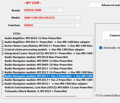

I tried the AlphaODB option selecting All Radio Navigator module MY2017_Var.1 and Var.2 and could not connect..
Using ODBlink MX+ adapter.
I tried other options and still could not connect to the radio.

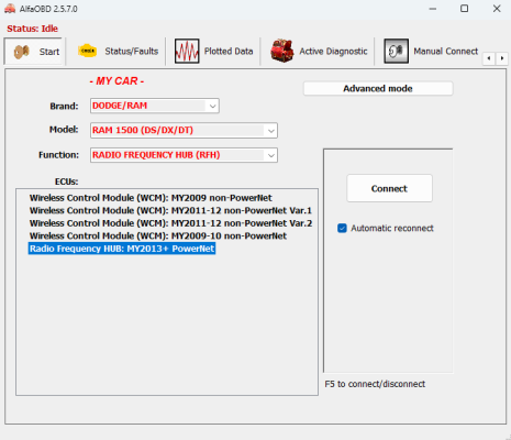

when you selected the module you wanted to connect to, did you actually click on the connect button? I know there is an autoconnect selection, but it doesn't always work
My '16 ('16's and '17's should be the exact same) needs that done every time I switch modules using MX+ and AlfaOBD on windows.
If you are looking for the PIN, go to RF Hub on the car model selection.
Then select read PIN

they told me the pin is for keyfob and not the radio code. I could not connect to the radio at all. I'm pulling the radio back out to get the serial number and try the 'hack' listed in the thread. if not then i'll try the service and then go to the dealer as last resort.
