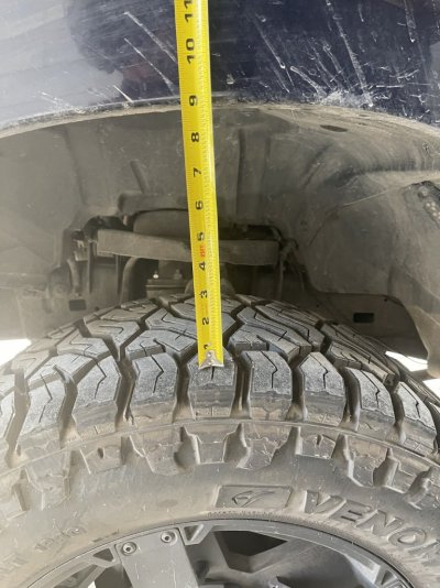

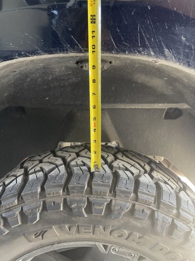

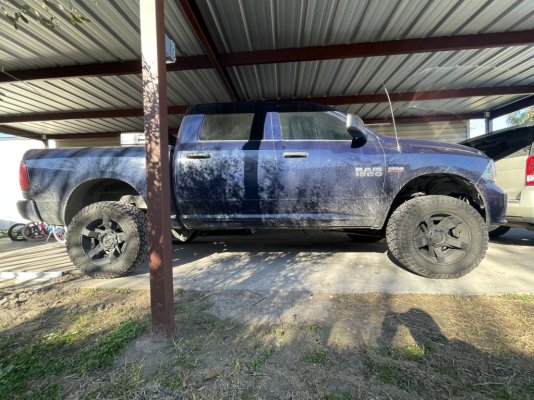

I beleive I have a Pro comp 4” lift installed on my truck and I hate the 1 inch rake it has in the front, I want to level it out and alittle bit more if possible.
It has oem size struts/shocks with a 4” strut spacer.
Would a 6” lifted strut raise my truck at all and will it be reliable safe to drive?

@BlueDemon there you go that’s a much better informative post.

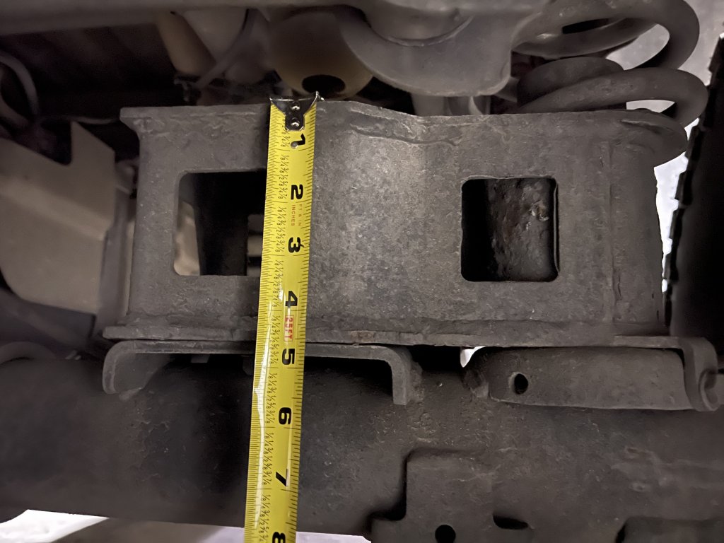

The rear spacer measures 4 1/2” right?

If it’s a 4” strut spacer you could install leveling struts or adjustable coilovers in conjunction and set them to the height you want instead of completely replacing the front unless that’s what you want to do.
Edit: also. The wheel well is not a good measuring point on these trucks. Your best bet would actually be to measure the body. Either to the bottom of the rocker or frame height. The wheel wells don’t sit even front and rear. I’m pretty sure they’re off somewhere around 1/2” to 1” but not 100% sure

His kits looking a lot like a 6” kit what do you think?
@BlueDemon what size tires are you running?

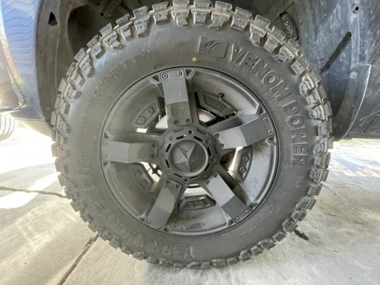

How big is the rear spacer? The tires are 35s on 20s. I’d say 6” lift. What’s the front strut spacer?

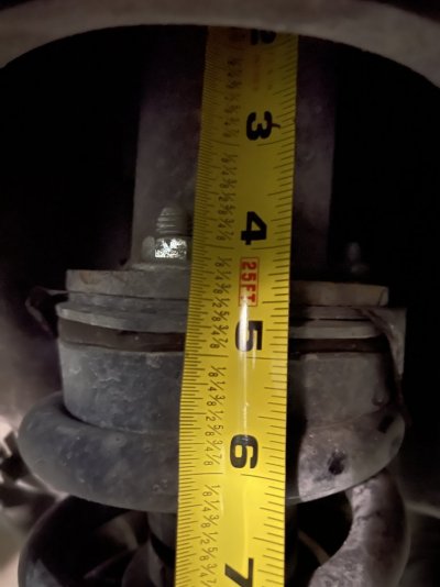

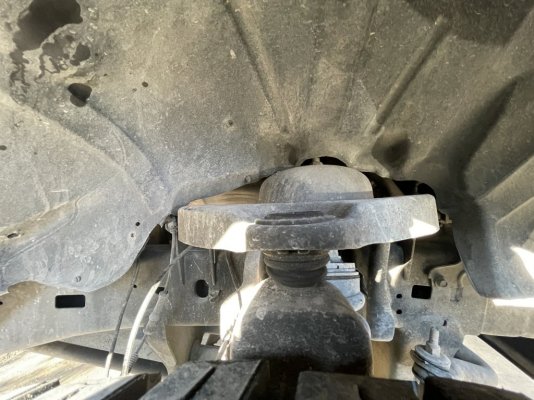

The front strut spacers actually measures 4 1/2 just like the back one

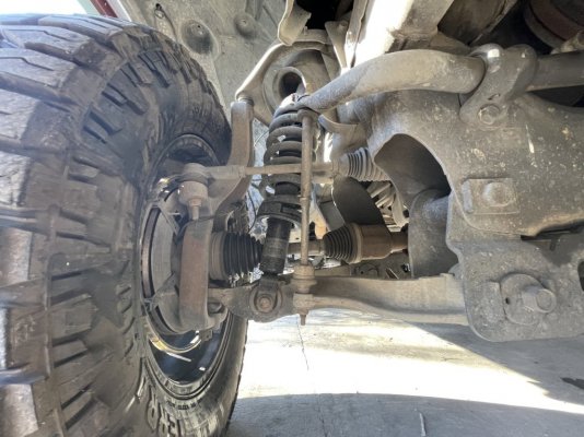

Can you get a better picture of the actual strut. More so the label on the strut and the bottom spring mount on the strut
It’s a quick strut (aftermarket)

100% I know the rear Procomp spacer is 4.5” on a 6” lift.

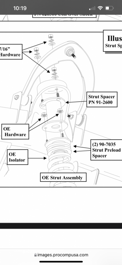

Procomp uses pre load spacers as well and I don’t see one at the top.
There the ones in the screenshot below

Pre load spacers where?
This is from the instructions and it may have been on the old struts before you changed to the preloaded(assembled) struts. And that’s where you long your inch F01DCE4F-DE97-469C-9636-C32524171CEE.png

This is from the instructions and it may have been on the old struts before you changed to the preloaded(assembled) struts. And that’s where you long your inch View attachment 485461

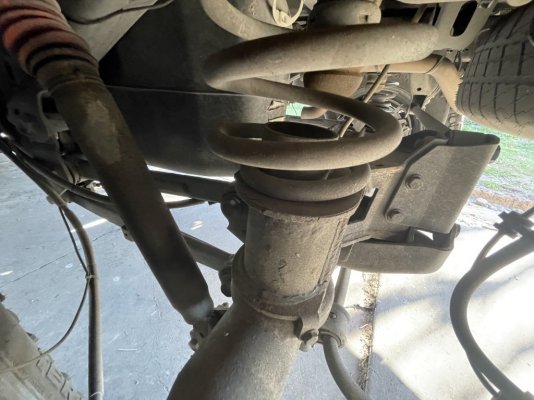

These are the old ones and they dont look like they had them. And actually just before I replace the shocks it was already 1” lower in the front. But last october when I got the truck it was actually level with the back, thats the crasiest part, somehow it lowered in a couple months
Technically you want the front down 3/4 to 1” because the hood sits up higher than the bed. So standing back and looking at the truck it looks level. But it’s your truck. The way to achieve level is have @Nick@GotExhaust get you a set of Bilsteins and zone upper control arms. Set your Bilsteins at the .7 that would put you where you want to be.
