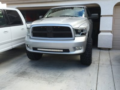

6" lift
37x12.50
20x12 -44
No body lift, no bils.
They stick out a good bit....about 3+ inches.
