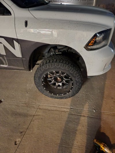

2014 ram 1500
130k miles
Lifted 4" rough country lift
Fuel hodtage wheels 20x12 wheels -44 offset
35 inch tires
Now the fun begins, lift was installed around 3 years ago at 80k miles and had no issues until recently.

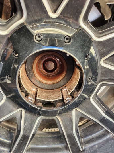

Front right Wheel broke off truck - sheered all 5 studs right off
Second issue
Few months later Passenger wheel - 3 broken wheel studs
Third issue
Passenger cv axel - sheered the axel/nut clean off at the hub
My guess is the oversized wheels are starting to show effects on the truck, I may have gone too long on tire rotations and may have had some the lug loosen up causing the wheel to fall off but it's not confirmed.
Anyone else experience this? 20230207_153722.jpg20230207_181649.jpgFB_IMG_1673990493758.jpg

What's the width and offset on those wheels? They look good but they may be exerting too much force on the hubs and studs. Complete bearing and hub assemblies are pretty cheap and easy to swap out, might be worth throwing in new ones every couple years as preventative maintence?
They are 20x12 with a -44 offset

You pretty much nailed your problem all on your own. If you keep the Rims, be prepared to fix the stuff you need to. Nothing inherently wrong with doing that, we all buy pickups for different reasons. Taking my car out for track days costs WAY more than using it as a daily driver, I know that and do it anyhow.

Sounds like the problem to me also. Quick example: Grab a straight broom by the handle up close to the broom head, put your hand at your side, and just hold it. Now do the same thing but hold it at the very end of the handle -furthest from the broom head. Supporting that same broom (or in your case wheel/tire compo) extended out take more strength. That is what you are asking the studs and bearings to do.

12 wide with a -44 offset is pretty aggressive, you’re losing an inch of width inboard of the hub and gaining 4 inches outboard of the hub which definitely stresses your hub and studs.
Your truck looks like a show/marketing truck though, I would just add hubs as annual or bi-annual preventative maintenance. I’m running 2 inch spacers on factory chrome clads with 37s so I plan on replacing my hubs again in a couple years too.

OP, did you replace the hubs before? I would go with as HD of hubs as you can get next time (same as axles).
