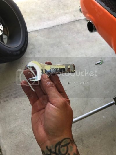

I know you have already completed the job, but for anyone else who is going to do it, take the wheel well liner out and use a 13/16 stubby on the inboard side. It's actually pretty easy. The stubby I bought from Amazon for a few bucks
And a pic of the install:
