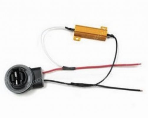

just one is needed, take the resistor and wire one side to the cargo light + and the other side of the resistor to the cargo light - and it will be fixed

when i had a 3rd that i needed to do that to years ago, i used to make electronics, i had what i linked you to laying around, i added that and it worked, im not sure what all resistors will work but it doesnt take much, if you have some laying around try em out

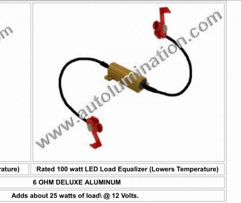

I just ordered a resistor from the above link. Now we wait. Its a 100ohm resistor and you install it between the positive and negative line of the cargo lights. It was $9.50 including shipping.

Its a 100 ohm resistor. Got it from this company.
LED Flashers, Electronic Flashers, Led Protectors & Load Equalizers | Autolumination
They have a link that specifies for dodge led lights

Just one resistor is all you need, hook it inline of the two wires like this....

I have a 2003 Dodge Ram 1500 and I had the same problem I used a 50 watt 6 Ohm resistor hook it up to the ground wire which is black and the cargo light which is white and it fix my problem hope this helps you

Okay im confused, someone said a 100 Ohm and you used a 6 ohm. What should i used?

What I would do, is go to this website and shoot this guy an email. He will tell you which one you need. That’s what I did when I had my last truck. I put a full-LED third brake light on my new truck but it came with a resistor already soldered in.
