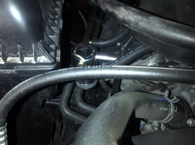

Catch can showed up at door today at 6:00 p.m. After I ate dinner I took it out to the garage to check it out. Well, I couldn't wait so I installed it. Only took about 15 minutes, hardest part was taking hoses back off to trim them down.

Congrats on the install. It will definitely pay for itself the first time you empty it. Nice pic of the finished product.

The can looks great. The easy mods are always fun.
