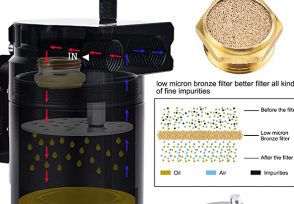

The catch can is SPEEDWOW XOO2105LQT. or FS01511BL
Is it this one?...
If so, there is a drawing on the Amazon ad which shows how to connect it. Connect the port marked IN to the PCV and the other port connects to the intake. Looks like that one does indeed have a filter in addition to a perforated plate for vapor condensation. Not a bad design for such an inexpensive CC. My biggest issue with generic CC's is figuring out how and where to mount them.

Is it this one?...
Yes this is the one. Thanks for your reply
