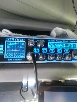

Getting a guy named hard drive to tune me a new stryker 955 for my 18 wheeler..Ill be testing his work and if all is good ill be sending my older 955 to him as well to be installed in my sport...Just so happens i have a cpl dueled coiled predator 10k ant that would fit the bill...Just gotta do it as super clean as possible..
radio pic......Just realized the dark blue color option in this radio will almost match my truck..hhhmmmm
