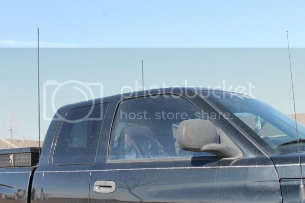

I have two 3ft off of the tool box with a gound run from the mount to the frame and just ran the coax out the back door and under the truck

I have mine mounted to the tool box, using firestick 3ft and the 3 way mount they offer. the tool box is grounded to the bed, which is grounded to the frame so it works just fine.
ran the wire under the cab into the engine bay and through the same hole I used for my lights.
