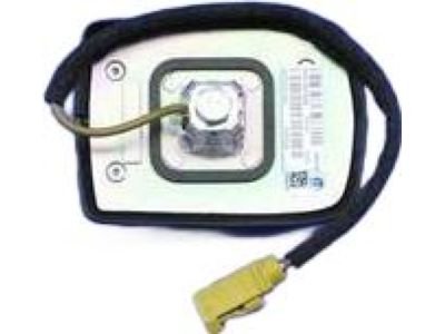

My truck camper hit my Shark Antenna when I didn't see a big hole while offroad and broke it. The shark Antenna is part 68324469AA.
Can I just replace it with the puck style Antenna 68328996AA?
The pictures on moparpartsgiant.com look like the mounting may be different does any body know for sure.
Shark Back
Puck Back
I also think the puck is missing the Cellular antenna but since I don't use the wifi hot spot or any of the uconnect subscription features I don't think that would be an issue. Does anyone know for sure? Thanks for your help.

Yep, plug and play swap. I'd wrap the cell plug so you don't here it rattling around. The gasket is integral to the antenna so you won't need any additional parts.

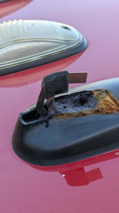

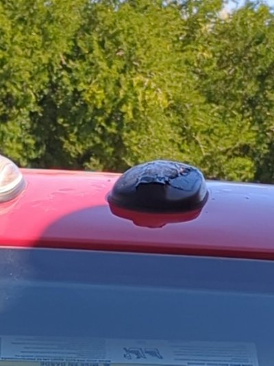

I figured up I would follow up on trimming down the shark fin. After some research I found that the fin was actually for the 4G cell antenna. Since I'm not paying for uconnect or wifi hot spot service I decided I didn't really care if it works. I also don't have XM turned on and truck didn't include nav so I was really just looking at a cheap and easy way to not have a leak. Since my shark tooth antenna had been damaged I decided to just cut the fin off and then seal it it up. Once I cut the shark tooth off you could see the 4G antenna.
I decide I wanted to give it a bit or a chance to work in case it was used for the Emergancy Vehicle Notification so rather than just cutting the antenna off I folded it over to fit were the damage had already opened. After folding it over I used some DAP Ultra outdoor caulk in black to seal everything up. We'll see if it holds up. If not I'll just get the 68328996AA and not worry about having any cell connection.
