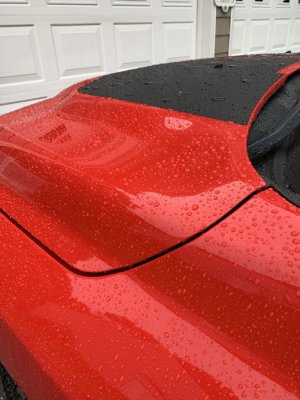

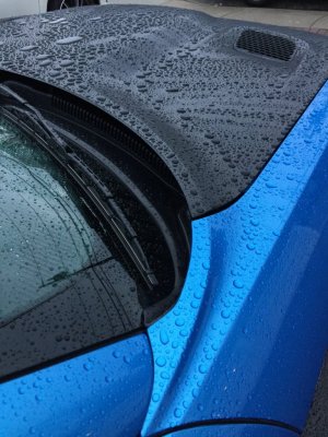

Full Disclosure....I am an old guy and have a severe case of OCD ( I make Felix Unger look like Oscar ) and have for years used waxes and sealants, many kinds and various brands through the years. But because my 2017 Ram 2500 (with a lift) cannot fit in my garage I decided to ceramic coat it. Having worked in my uncle's garage during high school and college i am pretty handy automotive wise, so I did my Ram myself. It was 2 months old when I did it. Power washed-then hand wash-then clay barred-followed by polishing using an orbital and Sonax Profiline Perfect Finish 4/6. Took me 2.5 days. Used GTechniq Crystal Light Serum with their EXO topcoat added. Came out amazing. 2 years have pasted and it still shines great, water beads off easily, and wash with a foam cannon. I was so impressed with the GTechniq that I just did my recent car purchase within days of getting it as well, doing all the very same steps. Some pics:
431542[/ATTACH]']UN8xh1Tl.jpg
431544[/ATTACH]']Q5bGUKAl.jpg

@mjf6175 - Your results look fantastic! Glad to hear you are still happy after 2 years (gtechniq is what is on my truck too). Do you use a "booster" from time to time? If so how frequently and what do you use? BTW...that car looks really awesome!
