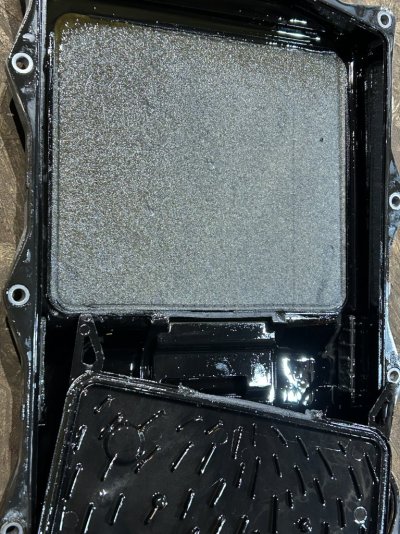

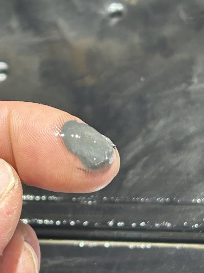

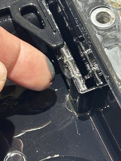

No.. not quite. One of you more fluid folks (pun intended), who have had a PPE pan for a while can dissect the filter at next change time.
Great pics. Two questions. Is that your first fluid change on this truck? How many miles?
My first yes.. the trucks first.. man I sure as hell hope not!
If you're actually comparing the filter median,i'd think you'd want to use new filters,but that's only my thoughts.Once they're used it's alot tougher to do a good comparision

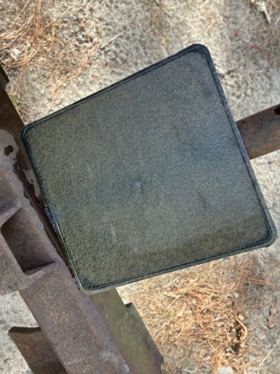

No.. simply because how much can the physical properties of the medium used change? Being used doesn't or shouldn't make it thinner for example. The material used should not be about to be affected by saturation or compression.
That oem piece I pictured above was no better than that ******, cheap-assed, ******* blue **** use in hvac filtration.

Part of what i consider a good comparision is feeling them,and shining a light through the filter material,and i've never had much success when comparing used filters because of that.If you watch alot of the filter comparisions where they're comparing the median material,they're usually always done with new filters.If you want to cut open used filters have at it,and let us know your findings

See I think the measure of a good filter is how much light shines thru after it's been used. I mean a nice, new, fluffy filter can look good but if the underlying material is weak (let's say), or has more elasticity than a competitor then it won't respond as well as one with different/better specifications.
Although on the other hand, an over-used filter could exhibit different or lessor physical characteristics than a 'properly' used one.
Yeah IDK I mean I guess I'd hope.. nay expect someone like PPE who wants to charge a premium for their product.. that they are improving not just the pan itself but also the replaceable filter. Which, let's face it, is the most important part of this entire ordeal.
