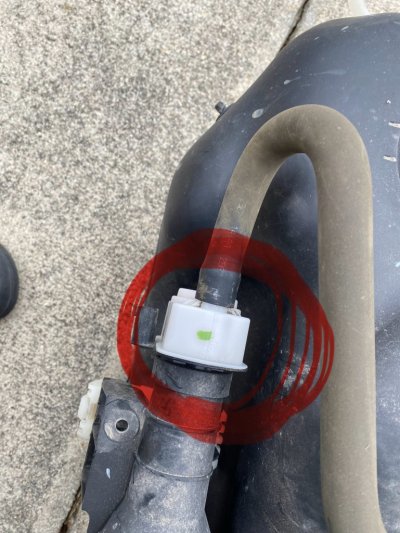

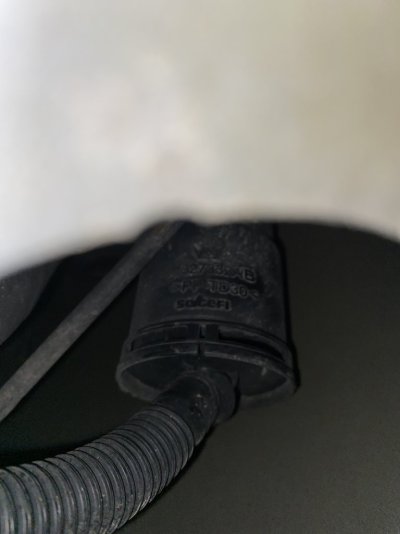

I’m my limited experience with the EVAP system on a 2018 I’ve found the P0456, small evap leak, code to be pretty much what Tom Davis outlined above. In my case the ESIM or evaporative system integrity module is the second part to check after the gas cap. While you don’t have a gas cap the sealing mechanism on the newer models still needs to be working correctly. I have no practical experience with this type of sealing system aside from my wife’s Ford has it and it’s nine years old with no issues so far. The ESIM also called the “charcoal canister purge valve” although it’s not the actual purge valve on Ram trucks. The ESIM is activated by the ECM to vent stored vapors into the intake manifold to be burned in conjunction with the actual purge valve which is up in the engine compartment under the engine beauty cover on the passenger side. Either one of these valves are suspect although the one in the engine bay is less suspect than the ESIM. The last culprit is the charcoal canister vent filter. It’s a pleated paper filter inside the driver side rear wheel well and if your truck has wheel well liners, yes it’s a PITA because that liner needs to be removed to get to it. Luckily none of these filters or valves/solenoids are more than $50 each. The one in the engine bay is easily accessible. The ESIM is a bit challenging but you can still get to it from under the truck with little patience. The filter is not hard to access but does require removal of the wheel well liner. I’ve attached a pic of the ESIM location on the fuel tank and a crude pic of the vent filter. Since you have a mechanic it’s best if he tests the system out to determine what’s at fault before firing the parts cannon at the code. Hopefully he has a emissions smoke machine to track down the leak although I doubt a 2019 would have a faulty hose yet. Good luck.
