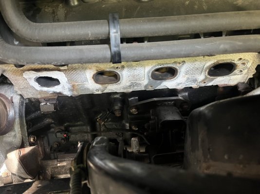

My mechanic took off my exhaust manifold to solve the famous broken bolts leak. I bought some headers to replace the stock manifold. When he got the passenger side off the picture is what he discovered it was thicker before the picture he tried to remove it . The driver side he can’t even remove the manifold it’s stuck on with the same stuff.. maybe JB weld.
He recommended I buy new heads and I’m not sure where to get the best deal and budget combined so I figured I would ask you guys. And also does anyone here believe that it can be fixed without getting new heads put on ? IMG_6951.jpeg

I would think a machine shop would be able to take care of that.
