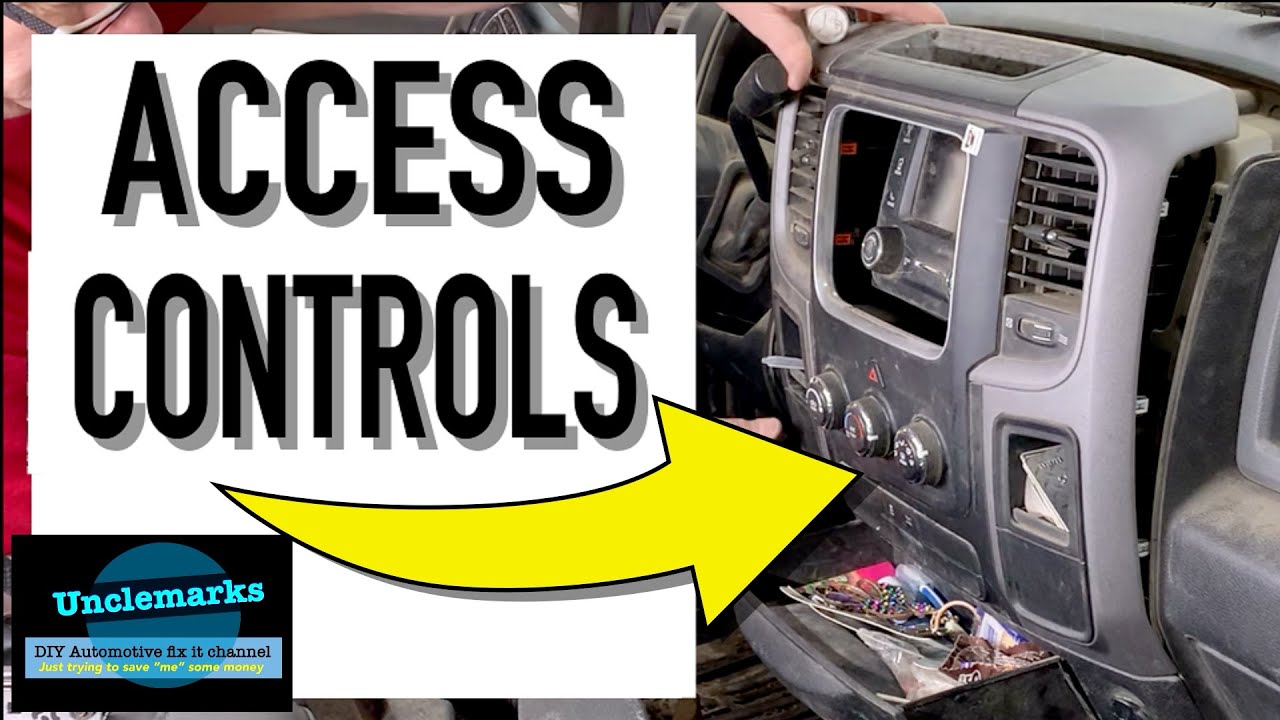

there are 4 actuators & doors in most Rams
found right to left behind the dashboard
1) actuator works the Recirculation Door, found behind the upper glove compartment
2) actuator works the Blend Door, it makes the Air pass over the Condenser or under the Heater Core. It is found by removing the Lower Glove Compartment
3 & 4) actuators work Mode Doors 1 & 2
They are found by removing the Bezel that surrounds the radio & the Climate Controls are mounted on.
There are 2 screws under the sun glasses holder, rubber pad.
If your vehicle has a 115 VAC plug, there will likely be a 3rd screw above it.
If you have a Full Floor Console, the upper trim on it has to come off, watch a you tube video for that.
If you don't have that console, then you have to remove the ash tray or what ever is down there at the bottom, again YouTube.
With that Bezel removed, you will plainly see the 2 actuators, within inches of each other.
every actuator in the HVAC unit are identical
watch this video, he filmed as he was figuring everything out.
