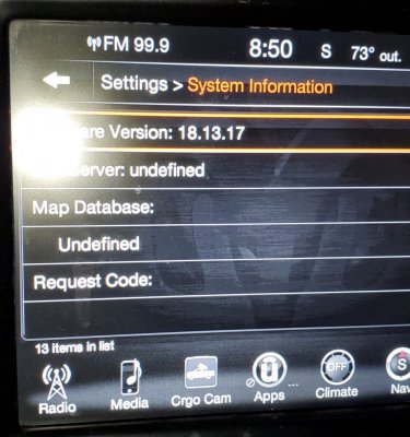

You guys are the pros. I just upgraded to 5th wheel and needing cargo camera.
I have a 2014 3500 Laramie cc. It has 8.4 with firmware 18.13.17. ALFAOBD has made it possible to turn on cargo but am needing specifics before I pull the trigger on a oem chmsl. Any help you could provide would be great. What is the possibility of the harness already being there. Thanks in advance 20200802_205203.jpg

Be advised, with recent FCA sw updates on the 2013-15 8.4 radios, you most likely can only have one camera input available to the radio (since v17.11.x was the only version that officially supported both at the same time).
@DeereGuy
Will hopefully take a look at this since he
handles the cargo cam stuff still.
Here's his dedicated site: https://www.kaodtech.com/
