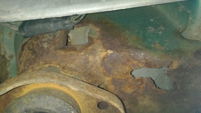

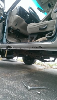

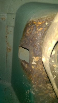

Well, I knew this was in my future, and the PA state inspection confirmed it. My 1995 Dodge Ram 2500 SLT standard cab 8ft bed needs bodywork in order to pass. It needs:
-driver door replaced
-driver and passenger rocker panels replaced
-driver and passenger front cab mounts (the steel brackets spot welded to the floor and firewall) replaced
Here's a few pics of the areas that are bad:

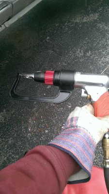

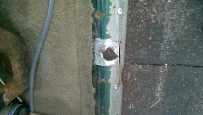

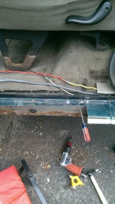

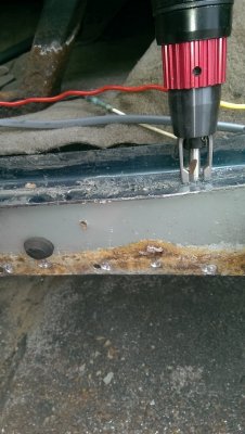

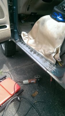

Here is some progress removing the old driver's side rocker panel. the rust damage went from just under the front of the door, back to where the factory cab corner overlays the factory rocker. So I have cut the replacement rocker down to just the area needed to replace. I bought an awesome tool from Eastwood for removing factory spotwelds (since I'm terrible at free-hand drilling them :)) You can adjust the cutting depth with this tool and it's a much more controlled process. Pics seen below:

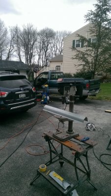

more pics. Of course, upon removing the factory rocker, I uncovered 2 rust holes that were about the size of a nickel but of course you have to cut back some to get to decent metal, so those had to be addressed. Then the last shows shows how I'm pre-drilling the spot weld holes in the new rocker panel with a drill press, truck in the background:

Checking in with some progress. Got the replacement rocker trimmed, drilled for plug welds, and welded in the replacement rocker, it's about 75% welded. All the top side plug welds are done, and the edge seams are mostly done. Then the bottom plug welds will be last. Then some Metal-to-Metal filler, sand, seam seal, prime, and paint.
