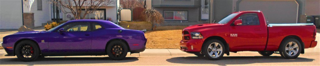

Last time on the dyno,my truck made 572 lb-ft at the tires at a lowly ole 3200 rpm,truck also plays with 717 horse Hellcats at the track,lol.I have a few buddies with KittyCats that won't line up beside it,as it's embarressing when a full size 5300 lb 4X4 beats them through the lights,lol.The truck was a bit of a sleeper ;)

So it’s not naturally aspirated. Sweet truck

I'm guessing your truck has the 8 speed? :33:

then Giggle gas? No bolt on’s are making that power. Thats almost 700hp to the crank if your at 572 to the wheels. Make a believer out of me? The TRX is 561 to the wheels.
You should post your build and whats done to that truck.
