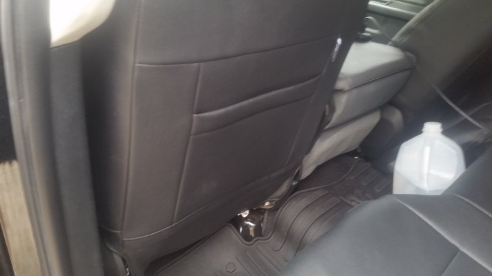

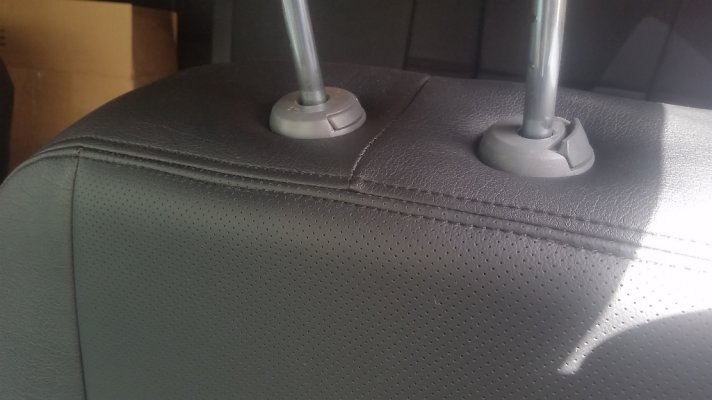

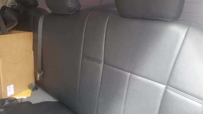

Not looking too good so far. One thing I noticed is the top of my seats aren't straight across like the others I've seen do this install. Thus leaving a lot of slack up there. Is there any way to remove the plastic clips that hold the head rest in place? So that I could put the cover beneath beneath them. The bottom section looks ok, but the backrest section is basically flapping in the wind...don't know if I received the right kit or not...

Put it over my cloth as well. Use the tool that came with the covers to pop the seat cover over plastic headrest clip clip. The leather will endure under the clips
The bottom back of the backrest I had to cut the factory flap with the plastic piece out of the way. That's the only way to get it to work. I confirmed with another member here before cutting and they had to do the same thing
It makes it real easy if you take the seats out and do it if you are doing it alone especially the back seat
Also after a few hot days the leather will tighten up and look good on the seats

Heard back from Clazzio, and they said the kit is only designed to be placed over the cloth, but that I still may be able to make it work. So now just debating whether or not to just remove the original seat skins (driver side has a tear anyway), just don't know competent I am with replacing the hog rigs.
