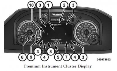

Hello, I have a 2014 Ram Big Horn. I have noticed some displays have trans, coolant, oil temps, & oil pressure displayed. I can't seem to get that. Is that a later version or option? Thank-you, Nick

Are you talking about the selectable gauges inside the EVIC display screen? Does your cluster look like this?
They are available on the premium instrument cluster.

Yes, that is what I have. I can only show oil & trans temp in #3. I would like to be able to have it in #1.

They show you how to navigate that gauge setup in the owner's manual. Basically you use the arrow buttons on the left of your steering wheel.
If you don't have a printed copy of the owners manual you can download one from Ram's website.

Scroll up or down until you get to the picture of the front of the truck. Then scroll left and right. I believe it's the second to last page it displays coolant, trans, oil temp and oil pressure and it'll be in the #1 spot (middle of the screen)

You must be in PARK to access those features as well.

These screens are switchable while driving. You can't access the customize options when the vehicle is in motion.

Thank-you all very much!! I am going to try it again. I have trans & oil temp in #9 currently. I like to look at real #'s on hot days or going up hills. Nick

I found that screen. I am going to blame it on gray hair and the dah factor. While running through the screens, I noticed the left-right arrows. There it is!!! Thank-you. Nick
