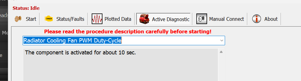

Yea, to do any tests at all, clear codes, or anything you'll need a FCA AutoAuth account and a scan tool that is registered with AutoAuth.
Or, a bypass cable.
@Damfarm
If you get a bypass cable, AlfaOBD can turn it on/off, so you can test the fan itself, and measure the voltage/duty cycle at the connector.
I know noone likes spending money on a bunch of stuff, but if you have a modern car and intend on working on it yourself, there's no way around it. You gotta have a way to access the computers. It's just as important as sockets and wrenches.
