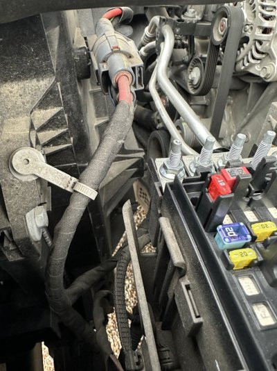

So here's something really weird. Yesterday, I disconnected the battery so that I could unbolt the first post on the relay box (see photo with relay box cover off - it's the first post on the left). As mentioned before, no fuse underneath, so I put it back on, tightened it well and reconnected the battery. The fan wouldn't budge when I tried to turn it by hand. Stopped work on it as I didn't have a multimeter and there was a storm brewing (I'm in the DFW area in Texas) and posted the problem here. This morning, I decided just to start it and see if I got a different code. Started up fine, and darn if the check engine light didn't light up. I checked for codes, and none were there, not even the "permanent" code. Good grief.
Popped the hood after driving it, and the fan is running just fine. No excessive noise or vibration, running normally. Stopped the engine, let it cool, turned the fan by hand, and it spun like you'd expect it to. Drove it 45 miles and it was just fine. I'm not a believer in "miracle" fixes, so I'm going to replace that fan anyway. But I'm stumped as to why it did that in the first place. I was bending the blade of the fan trying to turn it yesterday, today it spins just fine. Has anyone else run into this kind of issue?
Photos show the wiring for the fan. I'm assuming this is typical for the 2019-2023 1500 5.7. Looking toward and away from the radiator, one with the lid on, one with the lid off.

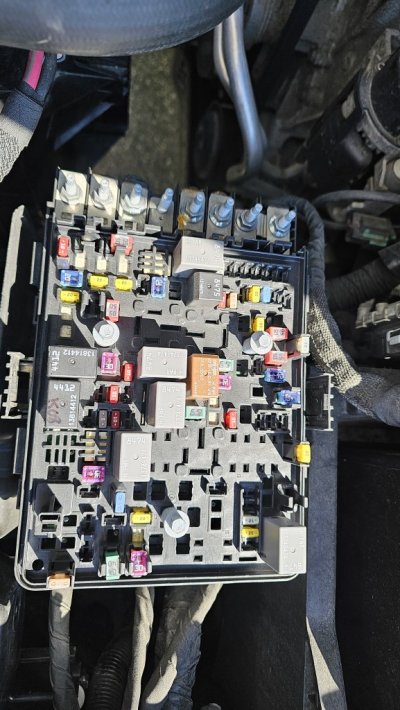

The radiator fan on my 2019 1500 Lone Star 5.7 has stopped working. Got the check engine light, and when i checked into it I got the P0480 engine code. I took to my local mechanic shop and had a diagnostic done. They checked to see if the radiator fan was coming on when commanded and it was not working. Checked for power and ground and power control module pulses with modulated ground. I got power and control ground from the computer, so i went and bought/installed a new radiator fan assy, thermometer, temperature sensor, flushed/filled coolant. The fan seemed to be working after this.
I usually start my ride at 5 am in the morning at normal temps and gets to 200 F in the 10 miles of clear freeway driving I do on my way to work. 8 hours later when I go home in traffic, whether that's freeway or city traffic lights. When the truck is in motion above 35 mph it does not seem to overheat, or it reduces the temp to normal range (most likely due to air flow) Its when I hit traffic, extended red lights, that the temp goes up to warning levels, and I do not hear the fan engage like it did after first replacing it.
I've replaced all the same parts (noted above) a second time and still the same issue.
Thanks in advance for any help!?!
