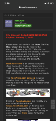

Next time look on rockauto.com . That’s where I got mine for around $50.00 a piece using the discount code on this site since they are a vendor here. Glad to hear all is good.

rockauto is the way to go if you have to order one. You could replace all of them for what oriellys wanted to charge you for 1.

Don’t forget to use the code to save a little bit of money!

Awesome man thank you I really appreciate that you already saved me a bunch of money by telling me to go there cuz I never really ordered stuff off of RockAuto or any places like that always just go to my local auto parts or the dealer but they're a hell of a lot cheaper over half the price cheaper I will definitely be using that
