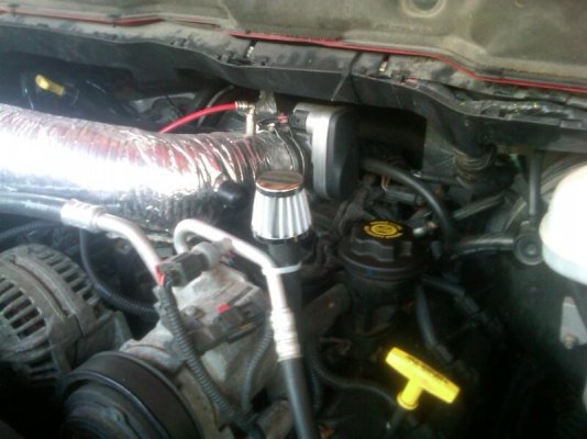

I made a change today to my CAI, as I took the crankcase breather tube off of the CAI duct, and installed a separate cleanable filter. This will prevent oil vapor from going down the tube and fouling the throttle body. The filter in next to the oil level dipstick. :waytogo:

Yep, that's how I did mine. Also makes it just a little easier to remove the intake tube.
