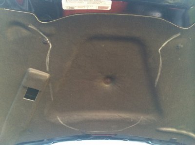

Totally agree with the previous comment about the vararam, while it looks cool fitment is poor. I did a chalk test on the seal, discovered it does not seal completely against the hood. Considering returning.

How much warm air do you think is actually going to come through those 2 corners where your chalk line did not touch the hood liner? With as much cool outside air as this intake brings in from the front, those 2 small corners are not going to hurt anything. Even with OES posting a negative review about the fit, it still knocked .3 off his 0-60 time. If that little bit of heat was an issue, he would not have run that much faster than stock. I know I have said it time and time again on here, but you will not find another intake that outperforms Vararam on a 4th gen truck...period.

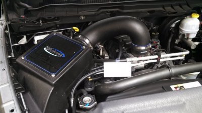

I love my Vararam and install was easy and fit would was good (I did cut a little notch for the cooling lines). Peformance gains were definitely noticeable, too.
Before and afters
