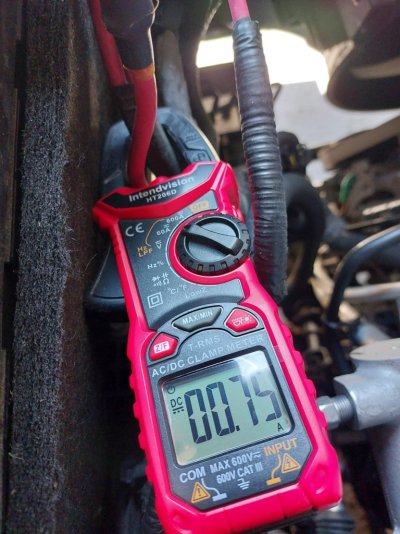

Hi.. also a new battery drains empty in 12hours
Mystery currents are common in vehicles loaded with electronics.
There are a few different techniques to isolate the source.
I prefer using a DC clamp meter.
Searching threads here, you can read about other methods.
Before starting the tests, spend time measuring the current draw on all of the large red wires from the positive battery terminal. Measuring before and after the sleep state. Number the test points and keep notes of the values.
Then lock the truck with the hood open. Leave the FOB in the house and come back after 10 or 15 minutes. I believe the sleep state measurements should not exceed 15 mA.
Someone more familiar with a 2009 Ram truck may know better.
I bought this DC clamp meter on sale from Amazon for less than $50 CAN.
There are many clamp meters to choose from.
I chose this one because of the 6000 counts sampling rate, and the resolution scales are sufficient.
Pulling fuses is one method used, but there's always a possibility of waking the sleep state and having to wait for it to resume before continuing.
I prefer to use the clamp meter to determine the amount of mystery current, then use a multimeter to measure the voltage drop across the fuses.
Using the fuse voltage drop chart from above.
Once an excessive current draw has been found, pull that fuse and wait for sleep to resume.
Verify the current was interrupted by pulling the fuse with the clamp meter.
Until this mystery current is corrected, either disconnect the negative battery terminal or add a battery maintainer for overnight.
