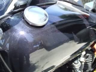

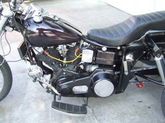

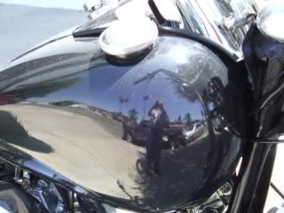

pretty sure they would sand blast the chrome off to do powder coat
You should know, Powder Coating is no longer just a basic spray in a couple of colors

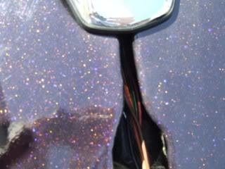

I have a few different Harley Gas tanks, that you would swear were Metal Flaked Paint
The Powder Coating was never buffed or Polished
yea, powder coating has come a long way honestly. one thing they will never be able to duplicate (at least for now) is the finish of real auto paint (done well). Powdercoating is not a base/clear and when the powder is melted the coating always has a sheen to it and a bit of orange peel. Its hard to get it very smooth and even if you do there is no real gloss or depth to it. You could clear over but I have never stuffed powder coating to apply a clear and I'm not sure how that would affect the powder base being scuffed. I do like powder coating on smaller parts for its durability.

The Powder Coating Shop that i use, did not even buff my tanks & i have not even waxed them.
I just wipe then down before i take a ride
I think they look great, 1 set of tanks has a blue metal flake & the other set has a red metal flake appearance
