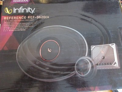

I just finished doing mine. I have a regular cab. I replaced the rear speakers with Infinity Reference 2way 6x9's and currently have Kicker 6x9 2ways in the doors. I bought the Infinity Reference Component 6x9's to match the rears but haven't gotten around to having them installed yet. I kept the stock radio Uconnect 3 I think with 5" screen pretty basic. One thing I would recommend is getting a good line out converter. I have the Audiocontrol LC7i (it has features like internal summing, bass restoration, etc). This will give you a clean signal to work with and you can still keep the factory head unit. The amp I chose is Alpine MRV-V500 5 channel. Good clean power in a very small package. The power ratings are very conservative for this amp (running my sub at 2ohm, amp birth sheet says 345 Watts rms instead of listed 250 watts). For subwoofer I went with Kicker 10", perfect fit behind the driver's seat. I'll try to post some pics
